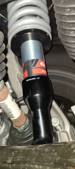

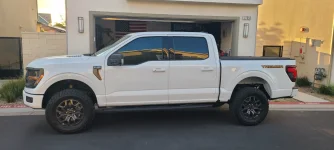

Got everything installed today and the ride is night and day difference. Super satisfied
However.....the front is still about 1.5 inches lower than the rear. The front is maxed. Hoping it breaks in a little bit.
