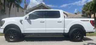

Update: I took the struts off of my blue truck and installed them on my new white truck. Same process. The only thing that I would add to the write up is to use the existing marks from the LCA nuts and bolts as a guide to reinstall them in exactly the same spot. That will eliminate the need for camber kits.
Do you have more pics of the spoiler?

Also, I suspect on your new Tremor those are Husky Mud Flaps ? Was looking for the lowest profile I could find. Those look nice ( for Mud Flaps ) Your tremor looks good :)
