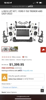

So even after trimming crashbars, front inner fender, rear inner fenders I continue to rub on full u turns and basic turns on uneven terrain or transition bumps from street roads to house, business etc. So I’m searching wondering if a 4 inch lift would remedy my issues. I’m currently running a 2.5 auto spring lift on 35/12.50 MT’s on stock wheels which I was fine on until I added 1.5 inch wheel spacers a few days ago.
Anyways I just came across this kit ( I think it may of just been listed as I hadn’t heard of it ) and was reading that it requires a 20 wheel or larger. Does anyone know if a smaller wheel ( in my case stock 18 ) causes clearance issues that a 20 or larger wheel wouldn’t?

Most diff drop lifts need a larger wheel or more negative offset to clear the lifted steering knuckle. The BDS kit you can run a 18x9 with 4.5-5" back spacing or -13 to 0 offset. If you go to a 20x9" you can run a 4.5-5.75" backspace or a -13 to +19 offset. Bigger wheel give more room for the knuckles. The RC kit is saying a 20x9 +6 or 5.24 backspace. I really don't want to run 20's because I off road so much. But the picture on the website shows the factory 18's. I think it is the same pic as the 2.5" kit.
