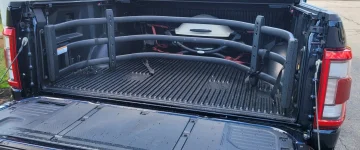

I've got this one installed. I'll get pics of it tomorrow.
Here's the pics

Riv nuts are your friend in this instance. That way you don’t have to remove the tail light. Let me find some more info.
That is the one. I ordered it and will just have to take out the taillights to put nuts on the back of the bolts to make it work. I will let you know how it works.
Removing the tail light is incredibly easy and the wiring harness is long enough so you don't have to disconnect it while you put the nut on the back side. The one that I installed was done the same way. If you zoom in you can see the brackets that I had to mount. There are tons of videos on how to take the tail lights out of an f-150, it pretty much hasn't changed for the past 20 years. Remove two self-tapping, I think they're 8 mm or 7 mm bolts right where the tailgate edges meet the bed. Grasp the tail light and pull backwards and it will pop right off. Like I said the wiring harness is long enough, at least on mine to set the tail lights on the tailgate still connected... If you're concerned with disconnecting the harness.
