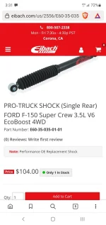

Good luck they only got one some cheap thou
