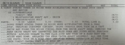

I worked in Ford product engineering for 40 years, and worked on this problem off and on the entire time, we call it a slip/bump, the process is still the same for the least 50 years, the splines are Broached and the sides off teeth the under a microscope are kinda saw toothed, about 20 years ago they started to plate the internal splines with Nickel trying to make the surface finish better, it helped, but still not perfect, The f150 Regular cabs were the worst because the back of truck so so high the slip yoke didn't like the drive line angle, the latest attempt(also started about 20 yrs ago) is Teflon grease Motorcaft part no. XG-8 This is only a temporary Fix, eventually the splines will get dry and the slip/bump will come come back, then clean the splines add the grease good to go (for a while)

Here you go, hope this helps.
