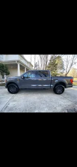

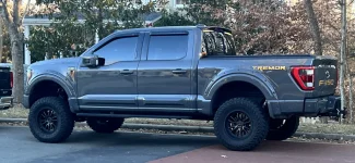

Finally got it done this week. Really loving the stance and ride. I had to navigate some holiday traffic and go over a larger median curb and ditch terrain and it was effortless and so smooth.
I had a bit of a squat with the 4 inch rear block but swapped out to the 5 inch rear block pictured and feel it’s pretty level. I can always adjust front coilovers with a $25 spanner wrench Fox sells for their 2.5’s.
I’ll put up a bunch more pics tomorrow when I get a chance.

Hoping OP can comment. No issue with installing BDS lift kit....even though they say they haven't fitted to a Tremor yet and can't confirm their kits fit? Would love to go with the 4" kit (5" true lift with the Fox coilovers) that I did on my '19 Lariat. Any complications at all installing kit?
I had my local shop install but they did not encounter any issues. I can tell you will want the 5 rear block as their is a choice between a 5 and a 4 from BDS. They say the 4 gives a leveled look but that is for a regular F-150 since our suspension is different you'll want the 5" block. I love it, no ragrets!

What offset wheel did you end up going with? Struggling to decide which way to go when doing the BDS 6 inch.
hows the truck offroad with the 37s?
