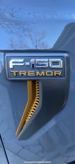

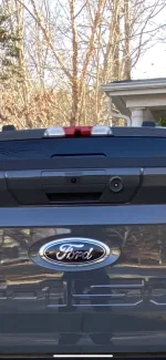

Like the post says, I spent a bit of time looking and couldn’t find anything besides options that still leave a chrome halo on outside of emblem.
Please share what you have done to chrome delete those areas, thanks!

PlastiDip it with a gloss top coat?

The emblems and side emblem come apart. You need a Dremel, and to reglue them together after youre done. That's how the companies that sell them custom painted do it. There are videos on YouTube of how to get to the front and rear emblem, and then when you turn it over you Dremel the pins off and it comes apart. Paint it, reglue it, reinstall. Same for the side emblems.
I have this on my to do for the end of December, I'll post some pics then, but there are guides online. It's not tremor specific.
Thanks for a solution, I’ll look at YouTube.
