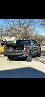

When I first upgraded to 35/12.50 on my stock wheels I had no issues whatsoever but I also installed the 2.5 auto spring lift the same day. The stock offset makes 35/12.50 work fine without any rubbing or binding with a 2.5 lift. If you didn’t lift I’m not sure if it wouldn’t rub.

Dang, mind if i ask for a pic of the 35x12.5 on the stock wheel? If you have a couple angles, thatd be awesome. Really wouldnt mind going 295/70 but the price and options out there. Did you do any wheeling when you had that lift? Have you had the suspension at full droop and stuffed?

I never did any off roading, so no full droop.
Here are some pics I found.

Alrighty, that looks pretty darn good. You didnt have any issues turning at full lock? Maybe while on a slant and backing up? Have you been off road with the setup you run currently?

None…… until I added a 1.5 inch wheel spacer then I was chopping the 💩 outta my crash bars and trimming plastic. Before the spacers never anything I noticed and I would’ve noticed. I found some before and after spacer pics you can see the poke difference it made.
