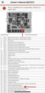

Cold start this morning, and out of nowhere I get this message. Didn't come back after restarting. Haven't touched anything related to the trailer system yet, so definitely strange and random. Anyone had this come up yet?

I haven’t seen it — but here are a few fuses to check:
1. Engine Bay Fuse Box — Check the “Trailer Brake Control Module Fuse” (30A) #42
2. Passenger Side Fuse Box - Check the “Trailer Brake Switch Fuse” (5A) #21
possible wiring issue.
