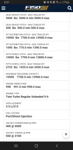

When I run my vin on my 401A I see 10,900. Is this right then?
@Jstonk - I can’t remember - do you have one of the towing packages and if so which one?
I ran a VIN from a ‘21 Tremor I found on a lot in November - 401a with the Tow Tech package. It said 10,900 as well. This supports either ALL Tremors are rated at 10,900lb or at least those with EITHER tow package are.

I’m leaning more and more to ‘they’re ALL rated for that’. And for my unique case, I doubt I’ll ever hitch to anything over 9000lbs.
If it is in the springs, I could run some airbags to help with squat (might do that anyways) or get different leaf packs down the road). Not feeling like it’s worth another thousand or two to me.
