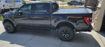

Was getting 17 MPG stock for first 1000 miles and then added level and 35x12.50 and now down to 15 MPG. Have MT and E rated tires, but only drive 10-15k miles a year so def aesthetic decision.
Looks great, but any modification will impact a vs stock drive comparison. Like others mentioned, what your main use is and willingness to lose a little comfort level are, everyone is different.
I don’t regret lift/tires, but would be lying to say it feels like a stock truck. Best of luck with decision and congrats on your new ride!

PS Added pics of stock vs level/35s side by side to compare the two

My first wheels and tires I ran 17" black rhino rokus +12 offset and bfg 35s with very minimal rubbing on hard lock in reverse.
I changed to 18" fuel blocks with +1 offset and I couldn't run my 35 bfgs, I ended up having to run toyo at3's 305's.. kinda dissatisfied with the toys but oh well.
The rubbing ofc is much worse on the toyos. But I got really sick of the bronzed looks of the rokus.
I have a 2" rough county leveling kit on it.
