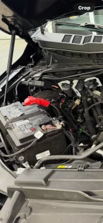

Apologies if this has been covered. I searched and didn't see a definitive response.
I am new to owning a truck, have had mostly sports cars. In the modern cars I've owned, I needed to hook up the battery to a tender if: 1) I did not drive it for a few days and 2) If my drives were frequent short trips over a week or so. There is so much running in the background on these cars that they have a parasitic drain and would throw fault codes erroneously if the battery was low.
I have some Nocco gear that is rated beefy enough to reuse.
A couple of basics for me: 1) Is this true on the Gen14 F150's - will the battery slowly drain if not driven and 2) Anything I need to be aware of in terms of the electronics so as not to fry or upset anything?
I am looking for exactly where to connect the negative clamp on a 2026. I believe there are few spots (although they are a bit nubby for the clamp).
I am not looking for a permanent pigtail install. I just want to use a Nocco Genius 10 I own with the clamps periodically.
Lots of information across forums on elegant pigtail installs and general reference to "don't connect to the negative terminal, find a solid unpainted connection point". Can someone smarter than me confirm the best location for the negative clamp?
Does the same apply for jump starting (or using the Nocco Boost products)?
Thanks

Such a device isn’t needed.
If the vehicle isn’t driven for 2-3 weeks or more, it’ll automatically go into deep sleep mode and disconnect certain features of the vehicle to maintain the battery enough to start the vehicle.
Also, any short drive of 30 minutes to an hour is more than enough for the alternator to recharge the battery.
A word of caution about the OEM battery.
They’re not built as well as they used to be so its lifespan can be hit or miss. It’s not unusual for these batteries to die within a year or less so you definitely should think about replacing it with one from the aftermarket.

Thanks - good to know
A follow up question - if not needed for preventing parasitic drain, what about when programming with Forscan? I've seen reference that you need it connected while doing so. Might be in my future to get the adaptive headlights going and to kill Auto Stop Start.
Specific changes via FORScan are relatively quick so there’s no need to connect anything to the battery to maintain a charge.
On the other hand, if you were to update all of the modules in the vehicle with FDRS, which sometimes can take many hours then yes, it would be advisable and recommend to connect some type of battery maintainer / charger during said process.
