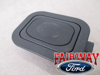

If your handy and want close to OEM, you can get the Ford switch:
and Bed lights:
Solder them up and run a wire up to the passenger footwell fuse panel and done!
THE FORD SWITCH IS A MOMENTARY CONTACT WONT WORK. Custom Auto Works has a bed lighting kit Switch operated Plug & Play snaps into factory locations

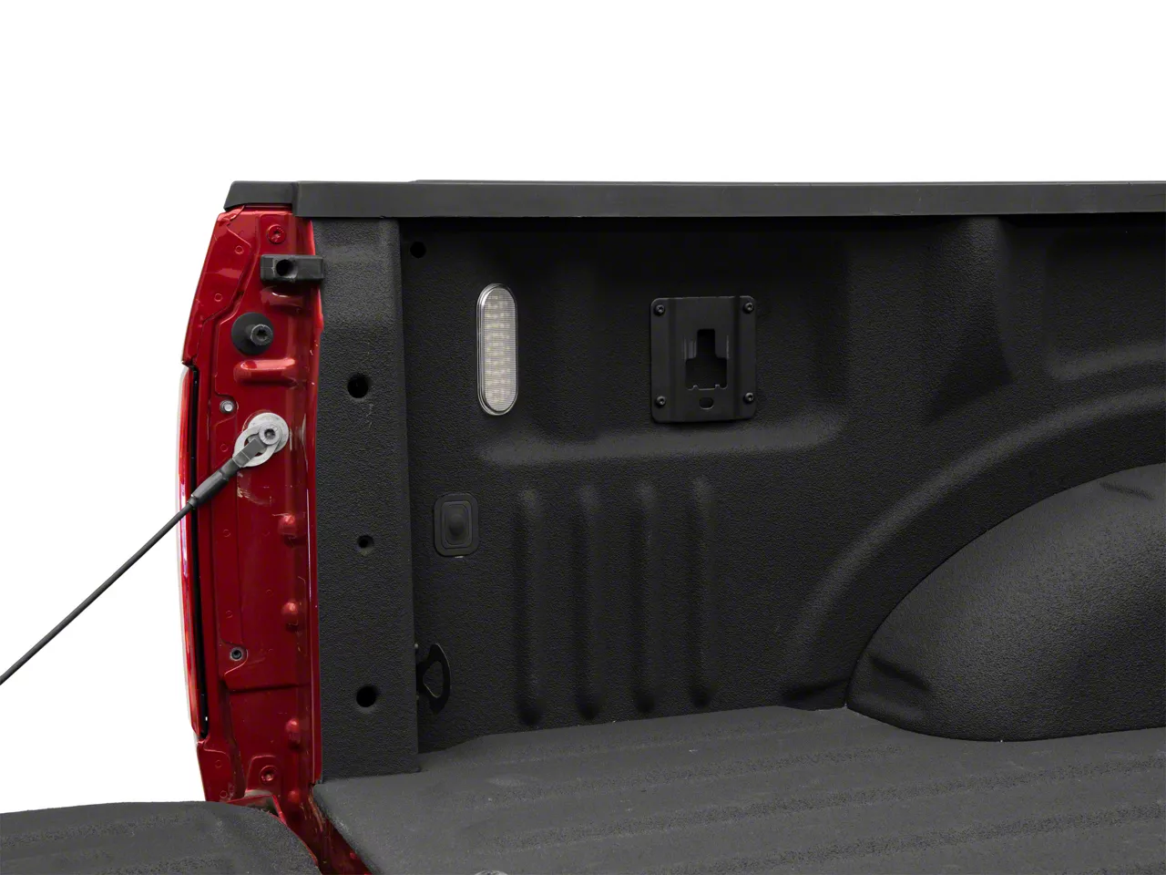

Just run the OEM harnesses and button
ML3Z-14A411-F
ML3Z-14A411-D
FL3Z-9C888B

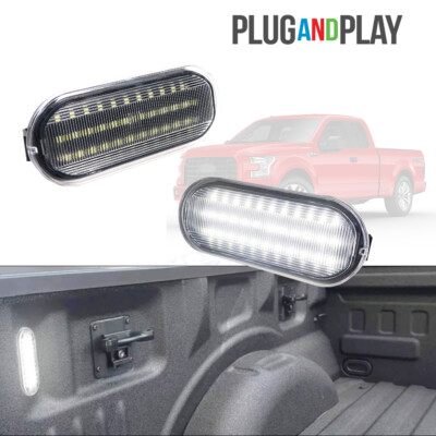

With aftermarket LEDs (cause OEM is overpriced)

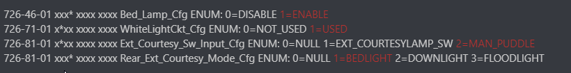

Program with Forscan BCM
forscan-bedlight-png-png.52402
Boom $900 savings no extra weight from tailgate bs

Yes! Worked great. About $75 for the cables and $25 for the lights. Enabling it on forscan was easy as well.
