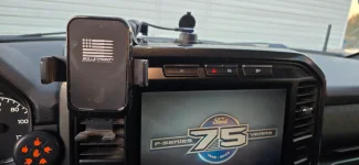

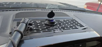

See previous writeup on install. This set up is a little pricey but well worth. Wiring not that bad at all.
How difficult is it to get power up top? Pretty easy
Does this solution charge your phone well? YES
Do the magnets securely hold your phone? YES bought off amazon
Link to the products
Bulletpoint rubigrid and motorized phone mount. Automatically grabs and charges your phone. Buttons on either side to open the arms to unmount. USB and USB-C ports added. Grounded to metal frame on radio mount, and single power wire to fuse box. I used the fuse for the moonroof since I don't have a moon roof.
I may eventually change the USB ports to something closer to being flush mount, though I would need to drill/cut the mounting plate, but the current port doesn't bother me
