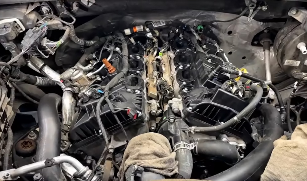

With dual injection (Gen 2 and 3 Ecoboost), the 'GDI service' is absolutely not needed until much higher mileage or if there is an actual carbon problem to address.

As MOE7 said earlier- with the Gen II ecoboosts, they added a second injector to each cylinder to keep the valves and intake track clean. There still the direction injection in the cylinder, but then a second one up in the intake track to keep the valves washed in fuel.
In depth info:
