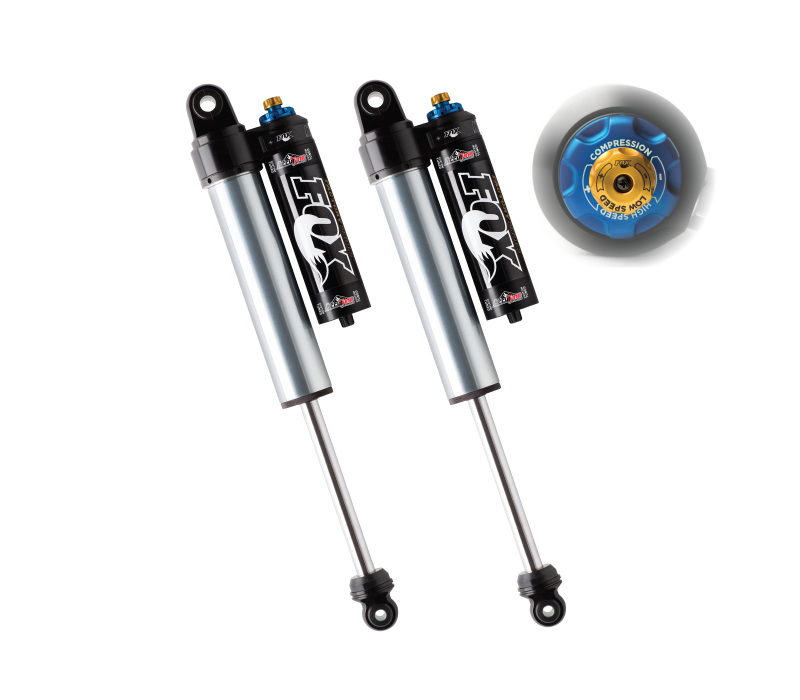

So I reached out to AccuTune Offroad since they seem well versed in the F-150 and I've never read a single bad thing about them. I'm OK with not having electronic adjustability of damping, but do want some adjustability. So I'm currently going with this setup with custom valving as a baseline (yes they fit 21+ trucks, according to AccuTune). I was going to go with the Fox Performance Elite but AccuTune stated they don't fit the Tremor well, and they recommend swapping the springs. These ones are plug and play:
Granted, these coilovers will likely not get me much lift, if any, in the front. But I don't care about lifting and want to keep the stock wheels and tires for a bit, as I did with my 22 Tremor. My 25 just got a Whipple supercharger installed (love the Coyote) and I'm mostly street oriented. I'll be swapping the rear block with a shorter one and possibly fully removing it like my 22.
If people get more feedback and experience with the Icon kits, I might change to the CDEV kit down the road. But for now I think the Fox kit will be awesome for my needs.

Yeah, I'm not fully understanding why AccuTune stated the Elites need different springs. Fox tech support said they would work just fine. But since I'm going with AccuTune and their custom valving, I'm going to listen to them. For now 😎

Mine were also tuned by accutune only because they made me believe that they would perform just as good as the internal bypass fox 3.0’s for a lot less money but that certainly wasn’t the case. I’m curious what spring rate they’re going to set you up with as my elite’s came with a 550 spring that just was a bit to stiff for my liking.
From the link I posted and I purchased, the spring rate is 550 lbs. They said they will not be touching the spring on this set. If I went with the Performance Elites then they would require a spring change.

OK, I thought about this a lot over the weekend and decided to have AccuTune change the order to the Performance Elites with their recommended coil spring swap. They are going to use Eibach 1500.300.0550S springs. Not 100% sure on the original spring P/N on the Performance Elites, but they said they will be too tall and too stiff unless they're installed on a PowerBoost. They said Fox knows about it but they haven't received enough complaints to change anything yet. Pretty wild if that's all true.
Either way, I trust AccuTune and wanted to go with the new seal technology and aluminum body of the PE's. Hopefully get them installed in the next week or two.

The Fox spring used on the elites is also a 550.
Do you know if the springs that came with yours were the original from the Fox kit? What is the part number of the springs?
If you got them from AccuTune, they said they had 2 F-150 customer complaints with the out of the box kits. They then discovered that the spring length and diameter were not a common spring and caused issues on non-Powerboost models.
So I don't think it's the spring rate that's the problem, but rather the other specs that make for a poor combo and maybe why yours didn't feel great.

It’s the original spring made by Fox, has you can see I had them adjusted as low as they would go and I still had 2.5” of lift. They use a 3.25” wide spring and eibach only makes a 3” so that was a problem.

Yup, this lines up with what John at AccuTune told me. He said that the Fox kit uses a proprietary spring that is basically too large in diameter and length. You might be one of the customers they were referring to where there were problems with the way it rides. So they're changing out the springs for Eibachs and the necessary hardware to hold the spring.
