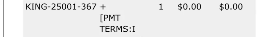

Those look great, does anyone have the part number for that set?
