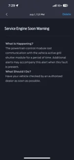

Got this warning after starting up the truck
Definitely the intercooler shutters!! When you get a chance shoot me pics of your install. You should have used my bracket!!
I’m assuming you ran your power wire through the shutters somewhere.
