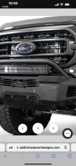

Pulled the trigger on a ADD front bumper
Same, like I have front parking sensors. So I'm now wondering if the only option is a custom fabbed bumper...based on the information in here anyway.
I spoke to ADD, their Honey Badger is fully compatible.
See pic showing parking sensors.

The 21 ones with the self parking has the sensors, they came standard on the 22's . ADD, DV8 and Fab fours all have bumpers that work for our truck and have the sensor relocation kits.
Right, I know some do exist. I guess my point/question was that the ones like the bolt on here won't work?
Pretty much any bumper for an F150 will work, you can buy a sensor relocation kit, and then drill and add them in. It all depends on how much work you want to do, certain ones come with them pre drilled, some don't. The only other thing is if you want to keep front factory skid, some will others won't.
Wait....I have 6 sensors in the front of mine and I have a 21 model. Am I missing something?
The bumper I installed has 4 sensor hole’s available, I just put small amber lights in the holes provided.
Has anyone with 6 sensors installed a bumper like this? Is it as simple as attaching a small sensor bracket? Not sure if I am over thinking this, but all these electronics on newer cars just dont like to be messed with.
