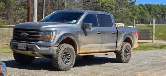

I have a '23 with Raptor Take-Offs and 315/70R 17 KO2's.
Changed out wheels and tires at about 800 miles and now have over 15k.
Did a ReadyLift 2" Level Kit and have absolutely no issues. No Rubbing, tires are wearing evenly. Mileage may have dropped slightly, but noting that significant. Running 36 psi Front and 32 psi Rear when not towing.
Truck rides and drives pretty much the same and noise level is also about the same. Bought tires at Discount Tire and have them Rotated/Balanced about every 6k.
Pictures with ReadyLift 2” Level.

Awesome. Thank you for the detailed reply. Have you noticed the odometer reading different speed ?
Looking at one of the Internet tire change calculators, it comes up to about 1.2 mph at 60 mph (33.6” tire vs. 34.4” tire). I have a Banks iDash Gauge that adjusts for tire size and it shows 61 mph when the truck Speedo shows 60 mph. It’s a little over 2% differential. Nothing that is really noticeable.
Makes sense. Im not worried then.
I’m hoping that once the Rough Country level kit and the raptor tires in I can still fit in my garage. Mine is 83 3/4 in tall. Wondering how much the actual cab goes up including the shark fins.
Your truck looks way nice with them. Congrats 🎊
Got a chance to measure mine this afternoon. Highest point on my roof is just shy of 80”.

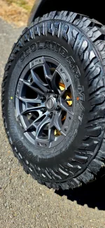

Has anybody seen these on a tremor? I believe they are off the raptor R.
Just the wheels not tires.
I do believe a little birdy down south of me just got some Raptor R wheels :unsure:
I don’t understand why they poke out so much at the rim. Is that so you can buy the ring and actually bead lock it?
I’ve heard not so fun things about bead locks, and i never air down THAT much
Edit: I guess they are just “beauty rings”.
