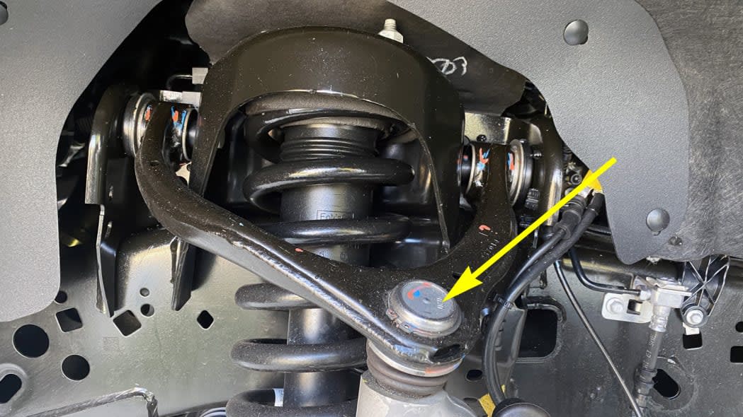

Need to replace the UCA on my 23 Tremmor (without blue cruise and auto beam headlights).
I have a 2.5 AS level already installed.
Coworker said JBA, they look nice but says not compatible with Tremor - but im not sure if they just haven't been tested on a tremor?
Ready lift is a comparable price to JBA
Dirt King is a bit more in cost, but looks really well built as well, but nothing mentioned about Tremors.
Does the Tremor have a specific UCA different from other F150s thats not a raptor?
Here is some good information from Hotshot Offroad (they have/had a shop Tremor) that is as comprehensive as I've seen for our platform:
They're also very helpful to talk through stuff; I'd suggest reaching out to them directly.
I personally have SPC UCAs and there was nothing Tremor-specific at the time.

Go with the newer SPC’s and call it a day.
As an alternative, here’s a new player that Shock Surplus is high on.
They also have a video talking about them.
