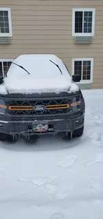

I just finished doing this for my 2025, but... I bought the f150leds adapter for the side marker light but if you run your headlights in "Automatic" the markers don't stay on. I even messed with FORSCAN trying to get them to stay on and couldn't get it. The only way I found to keep the markers on all the time was to run in parking light mode which doesn't work for me. So...I ran a new line from the fuse box (tapped #46) to the grill LEDs, so the "raptor lights" now are linked to the ignition switch and are on when the truck is on and my headlights are on "auto" and so do their thing without issue. I also think this will produce less static from my local Ford shop about modifying the electrical. (They enjoy giving me grief about modifying "their" truck.)
Note, the 150LEDs kit comes with a lot of extra wire which I ultimately chopped off for a cleaner install. The adapter and splitters are not worth the money in my view and also not worth sending them back.
If it ever gets warm here again, I intend to install a three circuit fuse panel on a relay for my audio and another set of marker lights but this works for now. Certainly a lot less extra wire under the hood.

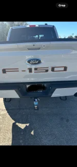

Bought it! Put the Tufskinz raised letters on the tailgate. Put a trifold bed cover on it. Really excited about my first Tremor!
