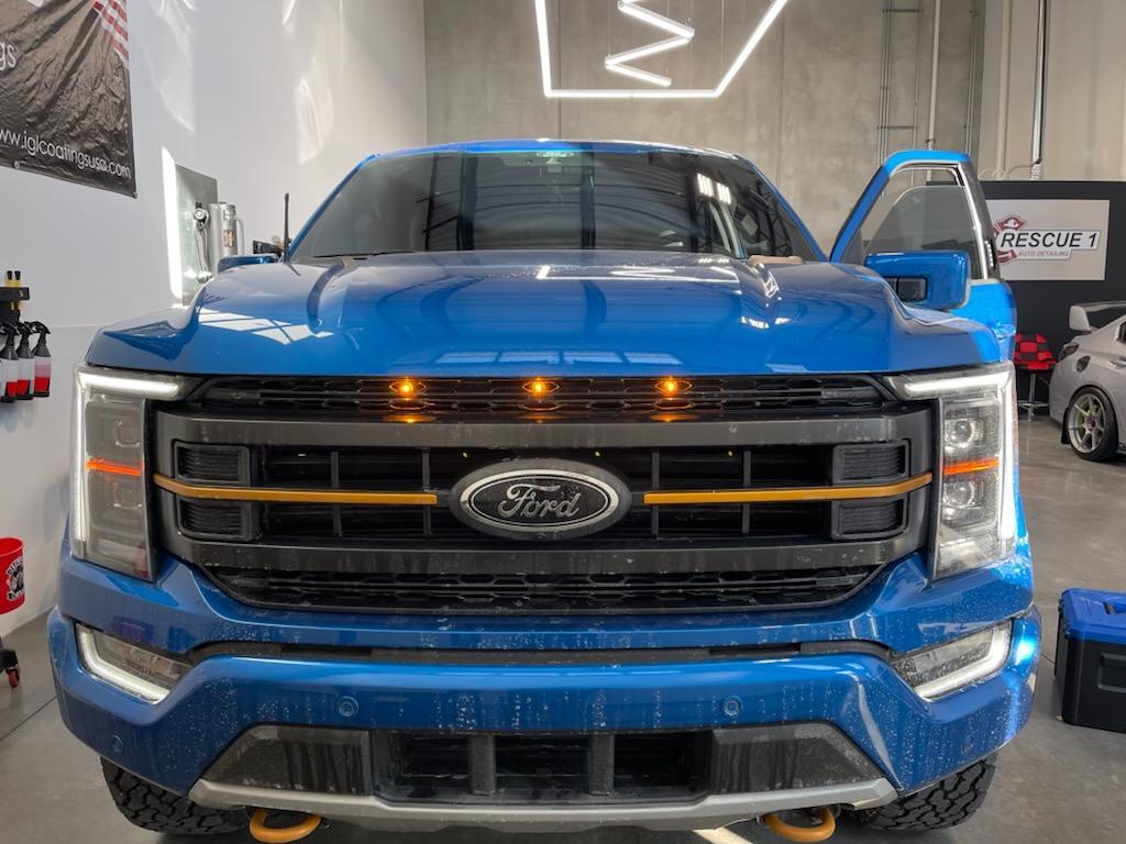

I installed the 3rd brake light and tapped into the BCM with boosted grey goose harness and I need ForScan to turn on DRL.
lookss great, what grill lights did you go with?
Thanks.
Just curious, does your truck have the glare free headlight option in the features settings since it's Canadian?
Mine doesn't have glarefree by the looks of it.
We have working Raptor 3rd brake light and the truck has Paint Protection Film and it's Ceramic Coated.
Used FORscan to turn on the circuit and also enabled Bambi mode for now as new to the software.
