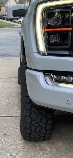

Would you mind posting some other pics like straight down the side to see any poke? I am working with Discount Tire right now for 35s and to decide on 17 vs 18 and whether to consider 11.5 or the 12.5 width. Ironically, also going with Methods, prob the 706 as I like the idea of bead grip.
Sorry I just saw your message, been away from the forum for a while. The poke is minimal. I’ll take some photos tonight and post them here
Ty, I appreciate it. I pulled the trigger since on some Method 706 (backordered in 17x8.5) and the same tires. So you won't help spend my money anymore but I'd still love to see 😉
Got some side shots showing the minimal poke (17x8 +25 offset with 35x11.5 Toyo Open Country AT3’s

For anyone considering the 35/11.5r17 tire, I can confirm it fits nicely and we had a good time on fairly mild rocky trail in Breckenridge (Bald Mtn Trail) last week, no rubbing stuffed/drooped with Method's +25 offset (5.7" bs).
