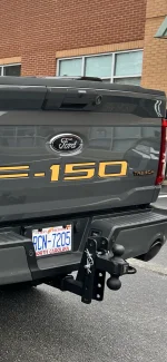

Drop Hitch Recommendation
17 3/4" from ground to bottom of hitch with about 150lbs in the bed

What size of tires do you have on it and how much of a lift? I will double check again later to make certain but pretty sure that's an accurate measurement.

Ok so I measured it in the garage where it's perfectly level and it's right at 20", the first measurement was in a parking lot so it wasn't exactly level.

Any recommendations for an adjustable drop hitch? I’ll be primarily pulling a popup camper that’s about 2500#s dry. It has a fairly high ground clearance and want something I can drop down when pulling a normal height trailer. Thanks!
I have the 4’ Bullet proof hitch. I wouldn’t recommend 4’ if not lifted at least 2.5’ ( that’s what I’m lifted and I use in upside down orientation). I like the hitch, very sturdy,good quality powder coat, tows my golf cart w trailer and 19 foot jet boat very well with minimal sag.

I've got a 21 Tremor with stock everything...do I need a 4" drop hitch or something different?
Weigh safe 4" drop hitch, if you want a drop hitch other wise just get a 2" drop which is all I use normally.

Not trying to Hi Jack the thread but can anyone tell me how much my rear will squat with 860 pounds on the hitch? Do I see airbags in the future? 6,188 pound Travel Trailer fully loaded it will be around 8,300 pounds. Also I will be using the Curt 17500 TRUTRACK Trunion Weight Distribution hitch rated at 10,000lbs.

Will your bed be empty? If so, you will probably be ok without any aids. But this is my truck with 6000 pound boat so maybe 400 pounds tongue weight, and probably 600-800 in bed. Not riding on bump stops, but spring is pretty flat, our leaf springs are very soft.

With a travel trailer, I would just use a WD hitch. May not need airbags at all.
