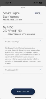

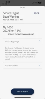

Truck went into limp mode, engine light came on after a long crank. Tried driving and it would not go past 30 mph. The rpm needle would climb but speed would not.
Opens the Ford pass and got this alert about the Fuel Engine Control System having issues.
Scanned it with a generic OBDII AutoLink and found two error codes
900C6: Fuel Rail Pressure Too Low - Engine Cranking Bank1
P0193: Fuel Rail Pressure Sensor A Circuit High

Update
Dealer performed EEC Test DTC’s
P00C6
P0193
P0193 Pin point test
Check PID monitor
Tested fuel pressure in spec
Re-set KAM & cleared codes
Performed software updates
This was last week.
Today check engine comes on again with same issue.
Should I ask for replacement of HPFP , sensors, both?
I’m in California, if I have to deal with this 4x it’s eligible for lemon law arbitration.
Hope it doesn’t get to that.
