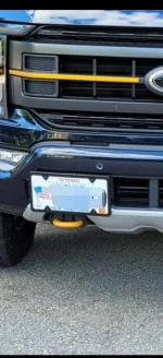

I went ahead and ordered the relocation bracket from Mishimoto. I'm going to install it this weekend and hope that it doesn't interfere with the parking sensors🤞. I'll post an update once it's all buttoned up.
I got around to installing the relocation bracket from Mishimoto, and I think I'm going to go a different route. The bracket has to be installed on the underside of the tow hook to prevent interfering with the park sensor above which is fine but I think it just detracts from the overall look of the front end.
Glad you said it not me lol only problem is idk where else it could go.

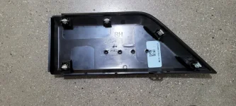

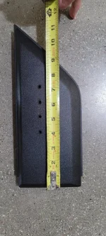

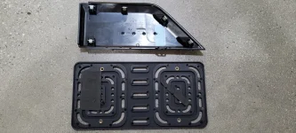

Ok, as promised here's my relocation result.
I ended up ordering 2 different plate holders from Amazon. In the end I pretty much only used 1 of them (the less expensive one 👍) but did use the black metal frame from the other. You could probably order it separately or use a different frame of your choice.
You can see I placed a small amount of self-sticking foam padding where the bracket plate bracket edges are a little far away from the bumper cover because of the curve of the cover.
I do recommend using some sort of metal frame or maybe every smoked out plastic cover over the plate to help strengthen the holder... As for me... It is often subject to wind speed over 90mph 🤫

Here is the Ford part number for the passengers side bumper cover -
ML3Z-17E810-BA

Fantastic work! This is exactly what I’ve been thinking of as well. Thanks for the links and how to!
Is the plate only held in by the bottom two holes? Is that enough to keep it secured? Thanks
Looks good I think I'll be doing this one as well, even could put some sort of quick diconnect system incase you need the tow hook!?
