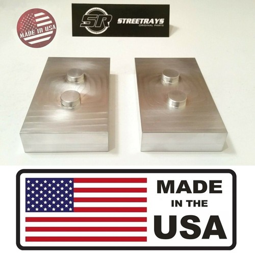

I took out the block without a problem but then put a 1” block back in to level it off with my quad loaded in the back. The original rake was 4.5”, without the block it was 1.5, with the current 1” block it is 2.5. With a 650# quad in back it slumps .5” in back.
What 1” block did you get and where?
I got the blocks off Ebay, though I can't find the link now. The one below is just a similar one. None of them seem to list for 2021 or 22 but I found that the ones for a 2020 fit fine. I didn't get the kit with u-bolts because I don't much trust Chinese steel. (The blocks would be hard to fail). I went to a spring shop and they custom made the u-bolts for $55.
Thank you!
I went to the my Ford dealer and got stock FX4 blocks for a 22 F150 and removed the tremor blocks. I also had to replace the Ubolts it sits perfect with a mild rake.
More and more I am leaning towards doing the AS 2" and the 1" rear block like this so I dont run into CV issues. Theoretically this setup would sit a bit higher than a regular F150 with a 2.5" level.
Do you happen to have the part number for the FX4 blocks that you purchased? What are the size differences between the Tremor stock blocks and the FX4 blocks? Do you happen to know roughly how much rake you have now with the new blocks installed? Thanks for posting the U-bolt part numbers as well. Your truck looks great with the new blocks installed.
Front from tire to fender lip is 6 1/4” rear tire to fender lip is 9”
The FX4 Blocks are 1” the Tremor blocks are 2 1/4”
It took less time to install the new blocks than it does to change the oil. I torqued the U bolts to 110lbs
