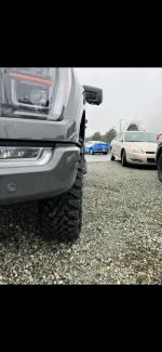

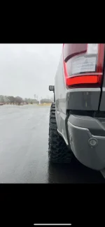

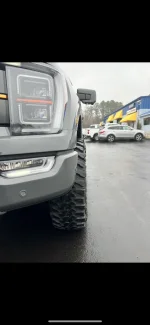

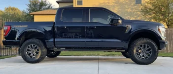

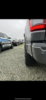

Looking good, just be aware if you add a 1.5 wheel spacer you’re going to have to trim considerably, crash bars both front n back several inches, wheel wheel liner, inner wheel well plastic as well. I’m speaking from my experience I’ve had 2.5 AS on my 35/12.50/18 Yoko Geo’s on stock wheels and all was fine till I wanted a lil poke and added the 1.5 wheel spacers. I only rub if I brake while turning or climb up a bump while turning, or any type of rough terrain while turning/ braking , quick uturns will also rub.
Nice n slow I’m good, and majority of everyday driving I won’t rub unless I’m driving a little too spirited.
I definitely plan on adding another 1.5-2.5 inch full lift kit down the line to eliminate rubbing all together and improve off road capabilities.
Here’s before 1.5 wheel spacer and after so you can see the difference.

Yep, love the look with the 1.5 spacer. I already have them but haven’t put them on cause i figured everything your telling me, I’d have to do. Not sure yet if I’m ready for that again. Did a good amount of trimming on my 19 FX4A3BB4BEF-4F83-41A6-8E13-6E96D3DBFF2D.webp23B5D84F-7A6C-45A9-B7B0-50B83DC947EA.webp9F5D1D0F-CA67-4DC8-B03B-31E8AFE3C9A4.webp

Sweet set up. Yep, I can see you did your fair share of trimming for that look. If you like a 6 inch kit and are ok spending the $ now you won’t have any rubbing issues ( see link below for options made for regular F-150 but 💯 work on the Tremor) . At the time I installed , early March of this year Auto spring 2.5 was a new option and there wasn’t as many lifts done so I didn’t know the difference a 1.5 spacer makes to the turning radius with a 35/12.50/18 on stock wheels. At the times when I do rub it’s like hearing nails on a chalk board for a millisecond or two. Overall I’m 💯 happy with the look, ride and handling.
