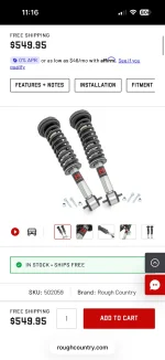

So is the 3” strut the exact same as the 2.5” kit?

Hey I did talk to rough country and they said it is the exact same strut that I have to adjust the snap ring. Would you be able to measure your truck front and rear ground to the fender at the tire? Thanks
Ok ya I am 40.5” front and 42” rear. I talked to RC and he confirmed the 2.5” and 3” M1 is the exact same strut. I took one of my RC 2.5” struts out today and as the pics it looks like it is on the 4th ring which I believe there is 5 total. Going to take to a shop get compressed and check out tomorrow.
