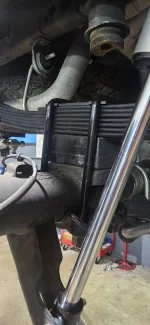

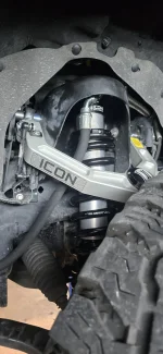

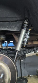

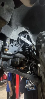

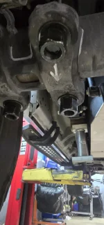

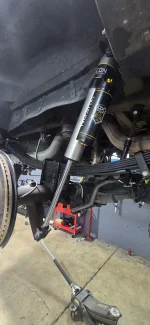

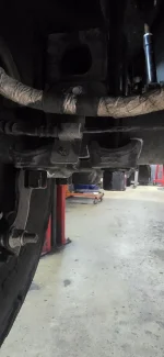

Finally got some parts installed. Got the stage 4 icons with leafpack, honestly they drive great. Significant upgrade over my RC fronts and vertex rears. Will be able to report better after the trip on Saturday.
Icon fixed the light bracket pretty sure because it went on with no issues. The passenger side redervoir mount and hose location might need to be adjusted, looks like it might rub at full articulation and full turn if you do both.

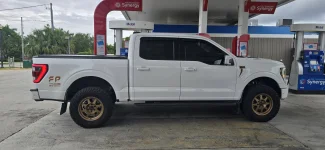

Im getting no wheel hop with the leaf springs now. The truck stance is perfect for me, almost level with 1/4-1/2" of rake.
Also got on the SPD downpipes and KN inlet pipe. Truck sounds great.... can hear the downshifts, significantly more responsive. It did throw a CEL even though they said it wouldnt, im seeing now if i can trick the o2 sensor with a spacer so it doesnt flag the CEL.

Might have to drive down and take a look. I keep eyeballing that kit but I don't want to go much higher (likely fine with the front adjustments) how much of a lift if any did the leafpack add?
Sports car...SFL...Tavarish has entered the chat. Sucks, what was it?
Maybe half inch add? The arch is much higher than stock, but also because it's more rigid when it seats.

Your headlight bracket is different than the one myself and Cblaxx got.
So I'm looking at it now and they didn't even use the part you and cblaxx have - i ordered it but its still in the truck bed unopened. I'm not sure where they got the bracket they used, maybe it comes with the kit now? Is the point of the bracket to separate it from the UCA?
I haven't noticed my lights being out of whack and it doesn't look like the sensor is being damaged.
Not sure what to think about that bracket anymore.
All great questions. Icon web page stated the bracket needed to be ordered for those of us with auto-leveling headlights. Maybe your shop could give some details as this looks like a good option. Out of curiosity, what is the height, width, and offset of your wheels and same for the tire? There has been speculation of what will fit with the billet UCA and Icon recommends a +6 offset with a 34x12.5 tire. The more I uncover with Icon they seem to not really do research of what is truly compatible and only provide what will put more money in their pocket.

This tire is right under 35x12.5, more like 34.75x12. Off memory rims are +18 offset. Zero issues with that side of it with this setup, from what I can tell so far.
I will add the leafpack bolts were too short and half the nut thread isn't on the bolt - I asked them for longer ones.
Need to go back to the shop after my trip anyways to fix the CEL from the downpipe, I'll ask them about the headlight bracket.
