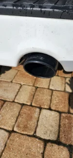

Alright girls, finally got the exhaust installed!
I had a shop do it just because I don't have time, but it's not a hard install. So you can do it yourself if you want to save some money.
I think it sounds and looks great. It's not a V8, but I appreciate the sound of all motors and I like the sound of a turbo 6 so I enjoy it. It sounds great under full throttle.

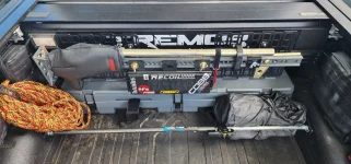

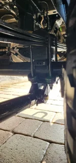

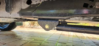

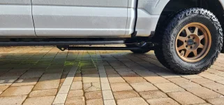

Installed the recoil traction bars - again easy install. Just bolt on. Hardest part is dialing it in because you can adjust it. It completely took away my wheel hop. If you rock crawl, this traction bar sits kind of low so I'd recommend something else.

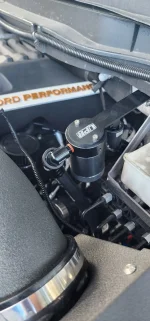

Did the UPR dual catch can, very easy install. I should have had it a long time ago but better late than never. These guys basically invented the catch can, suggest them if you get one!

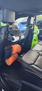

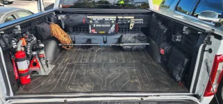

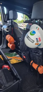

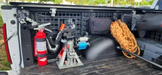

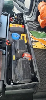

Organized my truck bed and rear seats - setup is looking and FUNCTIONING great.

How much of a pain in the ass was the drivers side tubing for the catch can?
Not bad. You need a special clip to remove the OEM but they are $10 at the auto part.
Glad the Recoils worked for you. It’s crazy how loose and soft the rear is without them.
Yes! I'm glad I returned the VAS set. Thanks for putting me on the recoils, the guys at the shop doing my exhaust loved them too. I have them on the first setting right now, going to bump them up one. What do you have them on?
I have mine on the softest setting, I don’t plan on power launches with the 37’s. I probably should mess with them, but the truck feels so dialed right now.

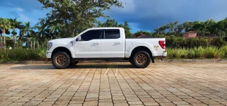

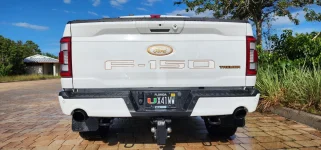

Wanted to share what I've added so far... my girlfriend named the truck Homelander, I figured it was fitting. '22 oxford white 402A, every option (Granger ftw).
Had to use IMGUR because my S22 Ultra takes some omega high def pictures and they apparently are too large for the forum. This is the whole album:

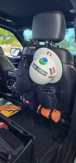

This post has my kit that is organized throughout my truck:
Awesome setup cant wait to see it in person. I have looked at most of the bed setup items before and haven't seem them until now in good pictures on a truck. Thanks

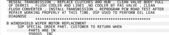

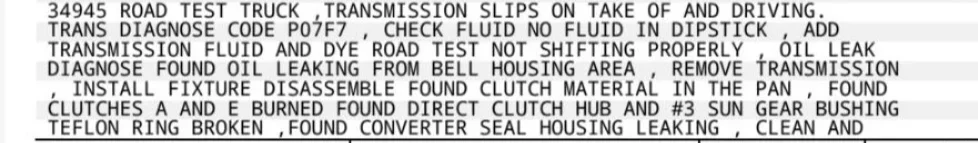

If anyone is curious what the service ticket description was for the transmission fix - basically it was all fked up. TSB 23-2250.
There's also a windshield wiper recall out.

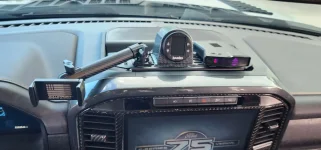

Got the ignition button painted and on. I need a new lettering stamp for it. My homelander sticker was too big for it so i put it on the windshield speaker cover, came out as a nice subtle touch I think.
What is that whole assembly up there for? I keep thinking that little thing to the left is a button and keep pressing it, lol
Pretty sure it's the assembly for the Incab mic and speaker for calls, and whatever else related to the windshield electronics (auto wipe sensor and all that)
Temp (the button) and humidity sensor (slots) on the left, CoPilot camera venting in the middle, and auto-wiper sensor on the right.
Mic is the little round grille on the headliner just to the right of Driver center, and calls come through the audio system.
If you have a sunroof the mic is off to the left

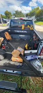

After a busy start to the year with work and parts taking forever to get here (~3 months for the icons), I have the following in the truck bed for install hopefully next week:
- Stage 4 cdcv icon front and rear coils with billet ucas and the leaf springs
- SPD downpipes
- K&N turbo inlet pipes
Stay tuned !

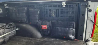

@Cranbery I looked through here but didn't see details on how you mounted the bulkhead rail in front of the retrax canister. Tell please! Thanks
Pretty simple as long as you are good with a measuring tape and an angle grinder. The way it mounts normally is to the truck bed with the stock mounting holes. I simply measured the distance between my builtright panels, which is shorter than the intended mount, and cut the long bar. Then I mounted the ends to the builtright panels. I cut it too long twice before I got the right measurement, but that was on purpose mostly because if you cut it too short then you're fked...
Looking back I only have one Pic, in it the long bar is what I'm referring to that you need to cut. Literally just make it shorter and mount the builtright panels.
