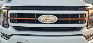

I did get the new key cover in from AJT designs. After seeing it in white, I decided not to paint it in the orange. Actually really like it and it matches well the truck color.

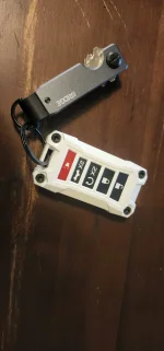

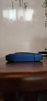

Size comparison I did for another member a little while ago.
Feels lighter than the stock FOB to me.

I like it better. Lighter than stock, slightly thinner. Imo looks cooler. The emergency key is stored in a compartment in the back without the anchor.

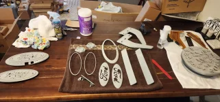

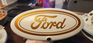

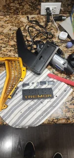

Captains Log, 02/24/23
- Took the day off work to get progress done on the installing parts taking over my office.

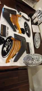

- My truck is 1/3 taken apart while everything is getting painted, took an hour or two to get everything off the truck using install videos and previous experience
- to paint: front grill trim, front emblem, rear emblem, side emblems, interior trim pieces, engine cover trim
- dremeling apart all the pieces to be painted took some time. I cracked one of the emblem pieces but it'll go back together fine - the black inside piece of the emblem can be tricky to get out without cracking it.
- then prepping all those pieces with a light sand, epoxy primer, another sand

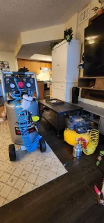

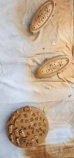

- fked up and got a siphon feed spray gun instead of a gravity fed and painting was so much harder. I only got the white on and i have to sand and hit another two coats because I didn't have the right air and fluid pressure on the gun. It was hard with the siphon feed point down also - going to get a gravity feed at home Depot in the AM.
- i got some coats of orange done on all the individual letters with some spraypaint i had left over from touchupdirect, but they need a final with the spray gun tomorrow when I paint orange.
- about 50% of the way, if i finish early I'll install my VAS traction bars

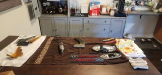

Shout out to my first mate (fiance) for letting me turn our balcony into a paint booth and our living room into a workspace. Shout out to my cat for supervising the whole operation.

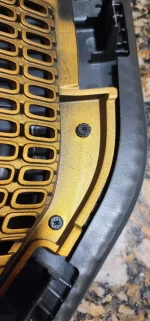

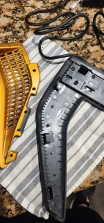

Captains Log Day Two:
- started the day with an upgrade to the compressor, was totally impossible with a 6 gallon.
- then a lot of sanding, and painting, and tacking, and repeating.
- had to get creative with the duct tape so pieces wouldn't fly away with the spray gun.

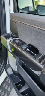

- decided to leave the interior pieces in carbon fiber because I realized it would be too much orange for my liking if I painted them. They are a nice subtle add now. Be careful if you get these, the odometer one and the sunglass one don't fit the tremor.
- clear coated everything and then started reassembly of the pieces. Overall not difficult, careful not to use too much glue.
- then install on truck. I have to acetone some super glue off my paint carefully tomorrow at the rear emblem but overall easier to put back together than take apart initially to be honest. Patience is key.
- I'd say it's about 80-90% as good as professional done, for 1/3 of the price including buying the compressor.
- very doable if you halfway decently know how to paint, have the right tools, and figure out a space to do it in. Main hard part was being in an apartment, would've been cake in a garage. And I'd have less imperfections in the paint, though overall it looks good in my opinion.
Was a fun project, im happy with the results.
More to come!
