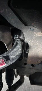

Have you had the SPC control arms installed yet? If so does your truck have the dynamic bending headlights and does the SPC control arm have a mounting location for the sensor that operates them? The only brand I've found that mentions the dynamic bending headlights are the Icon control arms but they also state they will not work with on the 22 model year 🤷🏻‍♂️
Mine are installed. Didn't check that, and i don't remember seeing a sensor on the stock ones that came off. I haven't paid particular attention to that feature after the replacement but I feel like it works still. I'll double check it.
Driver side has a bracket mounted to the control arm that holds the sensor which tracks your steering for the dynamic bending headlights. Maybe your truck wasn't equipped with that feature? 🤔
It definitely had it, i have seen it at night time and it's a fully optioned 402A. I'm wondering if they relocated the bracket, or if they didn't even know. I don't remember seeing anything on the stock UCAs before I tossed them, hopefully it wasn't still sitting on it. I'll look into it.
Is this it? It's only on the driver's side. The passenger side has a hole there but not this whole piece.
Looks like it has a wire and a sensor on it.

Yeah it looks like the spc uca incorporates a mounting location directly to itself. Where as the icon requires an additional part. This is a photo of the stock setup for reference.

Great! Thanks for asking, I didn't even consider it. Glad the shop knows what they're doing and SPC makes the parts right.

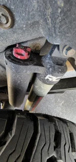

Alright fellow wallet Drainers, finally got around to installing more parts, and taking some pics.

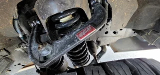

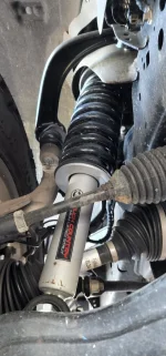

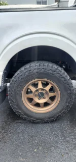

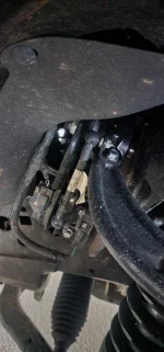

I got installed a few weeks ago the RC vertex rears, and the RC leveling front coils, with the SPC uppers. Here are the pics. So far so good, drives great, really enjoying the ride.

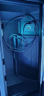

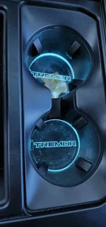

I did the media and cup holder light, it wasn't hard but it took a lot of patience and care. Imo worth it, they look great. I got the tremor plates off Etsy. There's a whole thread on this on gen14.

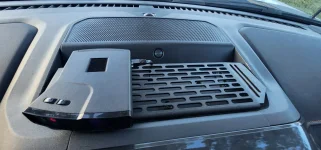

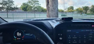

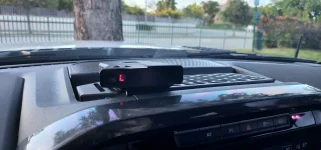

I also installed my radar detector, it's a valentine new version. I used the built right mount, which is great, and i wired it through the console while I was doing the cupholder and media lights. These trucks have mini double fuse or triple fuse, keep that in mind if you order a fuse tap. I only had a fuse tap for a regular double because I didn't check the fuse panel, and i had to use a wiretap on my dash cam wire to get the radar on, but it works fine. Looks very clean imo, and room on the mount for other things in the future.

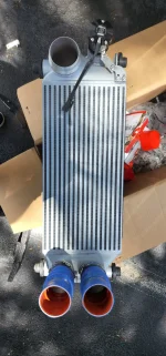

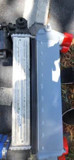

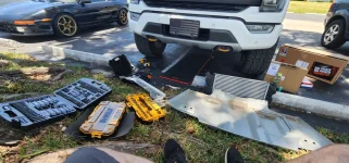

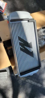

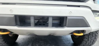

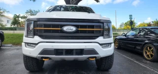

I did the mishimoto intercooler, turbo smart BOV today. Overall it wasn't hard, i did it without lifting the truck. It's a little tight but not bad. Highly recommend having a power wrench. BOV sounds great, intercooler looks great. I did it alone so it took a lot of upper body strength holding it in place and getting it bolted up - i recommend super glueing the grommets when you swap them over because they won't be as snug and if you're alone you won't be able to hold it all and bolt it in. I got the mishimoto front license plate relocation but I had to remove it because it triggers one of the front sensors unfortunately. Pics and video of sound attached. It feels good driving it.

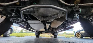

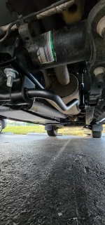

Also did the rear sway bar today. This took a while because they didn't send me two nuts and i had to go figure out new screws and nuts at ace hardware, but it wasn't hard. Also did it without lifting the truck. Kind of tight, but doable. Need a torque wrench. I did rip some corners and it makes a difference, much tighter. So far so good. Pics attached also.
