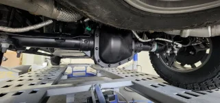

Today's update:
- installed RCI fuel tank skid (very easy, literally remove 4 bolts and reinstall)
- installed talon trans/cat skid (easy in theory, but the nuts are hard to get to - if you don't have a legit torque wrench or an air wrench, be prepared to put in some serious elbow grease to get the bolts off the chassis loose to put the brackets on that hold the skid)
- painted the rusted rear with the non corrosive black paint, looks a lot better. Couldn't get every spot but I did my best. I just did one coat as the coverage was good and it's just surface rust, two seemed unnecessary.
I recommend jack stands at the very least to work somewhat comfortably, i have a friend with a frame straightening lift that got high enough (although not a full height lift) to let us work. You can do it alone but an extra pair of hands helps, especially with the talon skid.
