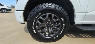

I've got 285/75R18 KO3's on mine and have loved them so far. I debated on the At4w for a while but liked the overall look of the KO3 a lot better. I heard a lot on the balancing issues on the KO3, but have had no problems at all with mine and they are quiet and ride like the grabbers in my opinion. Been great on and off-road.

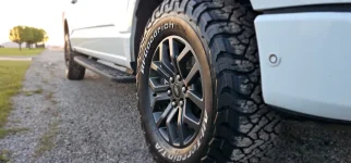

I purchased my Tremor used and it came with a brand new set of the KO3s stock size, stock wheel. I can't comment on the Grabbers but what I can say is coming from a King Ranch with some cheaper Rocky Mountain ATs at 32-36 PSI is WAY smoother than the recommended 50 psi of the KO3s. It has taken me quite a while to get use to the stiffer ride. I have heard others run the E rated tires at lower pressures to help, but you run the risk of sidewall damage or even blow out at sustained high mph due to heat buildup. They run fairly quiet but you can feel some of the tread vibration in the steering wheel when slowing down.. no issues as far as balancing my set. I don't believe I will continue with E rated tires after this set.
My daily driver is a 4.5 inch lifted Jeep Sahara Unlimited which had 37 inch Cooper STT Pro mud tires so anything other than a MT will feel significantly better. I recently changed to the Cooper Rugged Trek which is a hybrid MT / AT Tire. Seriously quiet, smooth, awesome traction and still agressive looking. It competes with the Mickey Thompson Baja Boss but is lighter, less sidewall stiffness and quieter.. I would even consider putting a set on my Tremor when the KO3s wimp out.. My Tremor won't see jagged rocks so sidewall protection is not my main concern.
What I can say about the KO3s up to this point (I have not had a winter with them) is they feel planted, good traction on dirt washed out roads, but might feel heavy and stiff due to the added weight and higher required psi compared to your stock grabbers.. And you may even see a dip in mpg. My truck showed an average of 15.4 when I bought it but over the first 3,000 milies and changing to 93 octane, I have been getting 18.5 mixed and 20-21 highway. I suspect it would be even better with the grabbers. ( 93 octane has been a huge difference)... My fatherinlaw has a highcountry and has 20 inch Goodyears on it making it feel like a car. At least the KO3s let me know I am in a truck..

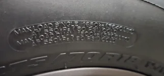

On what planet is 50psi the recommended pressure...? Read the sticker on the inside of the door- 35PSI. Adjust and it will ride way better.

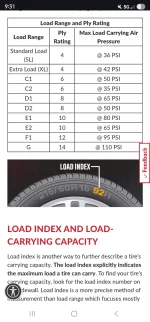

Yeah...so in case you didn't know, .. the stock grabbers are have a max psi of 44 and a different load index.. Which corresponds to the sticker and recommended pressure...The KO3 is an E rated Tire and has a max psi of 80.. They are two completely different tires and capabilities and require different recommended pressures.. There is tons of info on the interwebs concerning this if you ever decide to change out your stock tires. Even BFG recommended 50 ftont and 55 Rear for a similar sized K02... you can lower pressures as I stated earlier BUT. according to BFG, the heat build up will degrade the side wall and could cause damage... This data pull was all captured on planet Earth...

I was ignorant on this issue until I got the tremor and didn't like the stiffer ride. I thought they surely had messed up at the tire shop....As I dug further, and got edumacated speaking with BFG direct, I learned otherwise.... For us Jeep folks, I always just did the chalk test and found 26-28 psi on my 37s gave me the best contact patch, even tire wear and best ride.. of course 10 psi is even better on the trail. I am sure you could argue the same for the truck tire...run them low unless carrying heavy loads but again... not recommended by BFG...

I've got 285/75R18 KO3's on mine and have loved them so far. I debated on the At4w for a while but liked the overall look of the KO3 a lot better. I heard a lot on the balancing issues on the KO3, but have had no problems at all with mine and they are quiet and ride like the grabbers in my opinion. Been great on and off-road. View attachment 40306
SL, C or E rated? And yes the KO2 and 3 are the best looking all terrains hands down. The Mickey Thompson Baja Boss comes close but WOW they are heavy.
The idea of E rated tires heating up is overblown on the interwebs in my opinion. Sure, if your pressure is too low and the tire is deforming significantly with load/rotation you'll make heat, and more heat with a heavier sidewall. BUT - at 30 or 35 PSI a 10 ply tire isn't deforming significantly and won't be generating excess heat. The tire will wear better, track better, and ride better.
Ultimately, a tire counteracts the load of the truck. If you keep the load the same but install a bigger tire with a thicker casing you'll need less air pressure. The higher PSI recommendations everyone cite come from higher loads used in the calculation.
Anecdotally. I've went through multiple KO2s in casings heavier than my truck needed. I've always ran them at a pressure that results in an even contact patch across the treads (was 28 psi for my last truck). Most of my miles were highway. No tires exploded. Wear pattern was excellent with over 100k kms on every set.
Disagree all you want, but the only folks that complain about poor tire wear and poor wet traction with KO2s have them over-inflated.
They are E rated. Yeah I also liked the Baja Boss too but was too heavy for what I was wanting. I've had KO2's before and have always loved the brand. So far I have had the same great experience with the KO3's

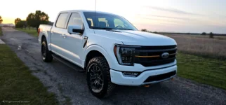

Got to say, getting the 295/70R18's installed with everything stock.....that size just looks really good on the truck. I have zero rubbing and the KO3's feel balanced as of right now as I have not been on the highway with them yet.
