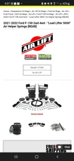

I've had good experiences with the air lift brand on previous trucks. I'm currently looking into it again for my tremor. Eliminates squat and really just creates a better towing experience.
Having personally installed multiple Firestone Ride Rite systems (no compressor, just bags) it generally takes me a few hours. Its all just bolt on, and their site doesnt specify either way about the Tremor, but I cant see any reason why it wouldnt work.
Yes they are very easy to install and totally worth it if expecting to tow. I just finished a chat with SD truck springs and they stated this kit would in fact work with the tremor. I've just planned my next purchase. 💰 💸
After returning the readylift load leveling, the shop called airlift and confirmed that this one will work, and not be in conflict with the scales.
About $1k with materials and labor.
