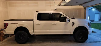

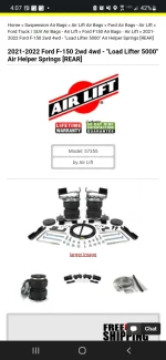

Just installed my load lifter air ride kit. Went on in a few hours and it rides good still. It helped with body roll around turns on my test drive. I have yet to tow with them but with having air ride on my previous trucks I'm confident it will be a much improved experience over stock. It does seem to sit a tad higher in the rear now though 🤷🏻‍♂️

Which model load lift air ride did you go with? What is the part # if you don't mind sharing 93355?
