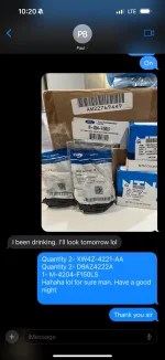

Check to see if it fits a 2017. The torsen is a universal fit for all years 2017 and up I believe. All the parts listed in the thread worked for me. There was one part number that was obsolete that was superseded by another part number but both will work
Are the quantities below correct for this mod?
QTY 1: M-4204-F150LS
QTY 2: XW4Z-4221-AA
QTY 2: D9AZ-4222-A
Its telling me that the bearing number wont fit my 2021. Its saying NL3Z4220A. I think its wrong because its telling me the race doesn't fit as well and the replacement is the bearing part I just gave you.
It might say it doesn’t work on the website because they didn’t update the cross reference dates or something but I can guarantee it works. This is exactly what I used.

I believe the part number has been updated and both the bearing and cup are sold as an assembly in one part number.
Well - with a few members going through adding a Torsen front differential to our trucks I thought it would be wise to consolidate information in to one place to help each other out!
The Ford Performance part number is M-4204-F150LS which is confirmed by Torsen directly to be the correct part.
Based on my internet research the carrier bearings needed are XW4Z-4221-AA along with the bearing races/cones D9AZ-4222-A. These are the Ford part numbers.
I was quoted $550 for the labor to install the diff by a local offroad shop in SLC, UT. They're a few weeks out but hopefully I'll have this installed soon!
Anyone else going through this journey... share your info and experiences!
