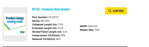

Can you folks confirm if these 5165's would be ok for the rear with the stock setup? Based on everything that I read in the thread looks like they would be suffice, but would like for one of the suspension guru's to confirm. This would just be for everyday driving with rare heavy loads (under 500lbs) in the bed only a few times a year. Looking for something better and more firm that the stock rear shocks. TIA.

Hey. The 5165 would be an overkill with the reservoir and for what you are describing. Unless you use it for off roading a lot. Just go with the B8 5100. I just found out the part for mine and its 33-253190. They are $112 each on good websites. Labor should be no more than 2 hrs. I went with the 5100 because I will be towing a travel trailer several times a year. And if I take it off roading it will not be anything crazy. From the research I did the 5100 would do great.

I agree with black Mamba. My use is similar to yours and I also tow a Travel Trailer that maxes out at about 7,000 lbs.
The 5100’s are reasonably priced, are slightly firmer than stock, damper much better than stock, and definitely work well without being too firm.
