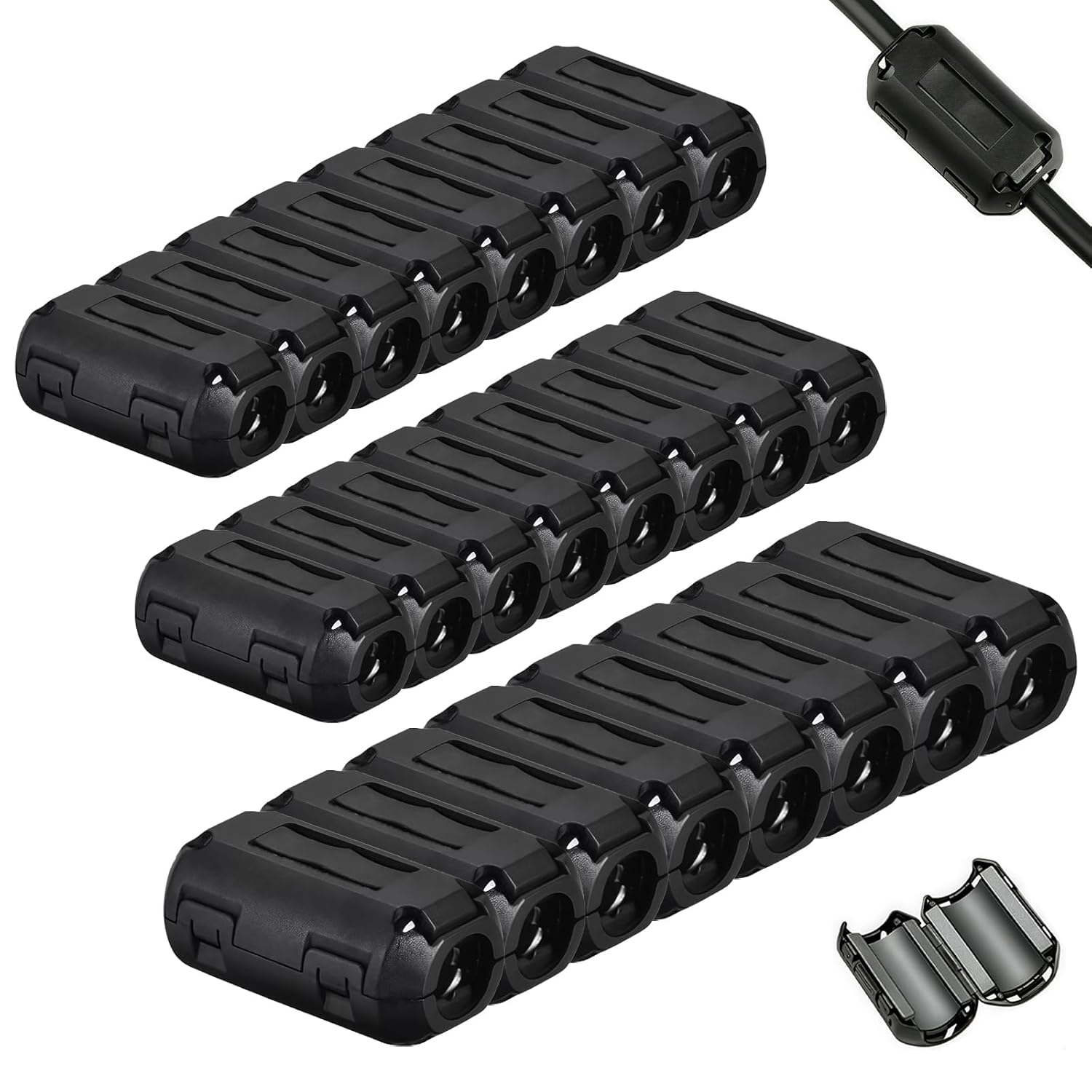

So I wired up the main power, its working correctly but I have a really weird issue. When the fog lights are on, the FM radio becomes almost all static. When I shut them off, no static, turn them on, immediately static. Is this something you've experienced of heard of before?
Which brand and model lights are you using? I've had this problem with Baja Designs lights in the past. Radio operators call this "spurious emissions" and the Baja Designs circuit boards were noisy as hell on my 2-meter radio for trail comms.
Diode dynamics SS3 Pro
Kind of a bummer. All I do is listen to is Detroit sports talk radio
I have had hit or miss luck using these, but you might order a set of ferrite RF chokes like these and snap them around the SS3 power leads.
