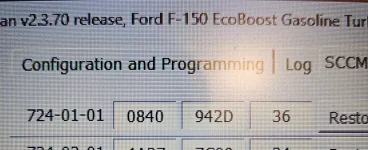

I'm getting ready to dive into FORScan for the first time. I've been going over Livnitup's FORScan spreadsheet. I'm a little confused on something...
EXAMPLE:
[add 04 (hex) to your default value for each additional flash
What does it mean by "add 04 hex"? If I want two more flashes, do I add 08?
quick and dirty how to read that spreadsheet: in the SCCM module, find address 724-01-01, in the value xxxx **xx -- change only the ** values to whats listed.
in the case of that specific example/the one you're working with theres hex/math involved. so if your default value for ** is 00 then you change it to 04 to add a flash. if you want 2 flashes over stock and your default is 00 you would change it to 08. where it gets hairy is if your default value is like 09 at which point adding 04 you would think 13 but '13' in hex is 19 in decimal so you really want 0D

OK, what if my default is 09 and I wanna add two flashes? I know one flash would be 0D… So what would two extra flashes be?
21 11
edit: im retarded
09+4 is 0D - 0A 0B 0C 0D
0D+4 is 11 - 0E 0F 10 11
Hex is base 16 so 10 would be 16 decimal

yup my bad i was lookin at the chart while i was mathin and was a row down :ROFLMAO:
The hex/decimal table was super helpful! Thanks to @T-Rob for sharing this thread with me. I can confirm that if you change the value in the non as-built format (i.e. from 3 to 5) it does also make the corresponding hex change in the as-built format. For example, my original value in the as-built format was 8C which means (according to the table) I would have needed to change it to 94 to get 5 flashes, but I only changed the non as-built format from 3 to 5, then went back and looked at the as-built format and viola'!
