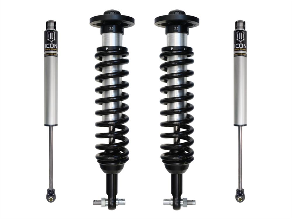

Icon vehicle dynamics front coils are adjustable with a spanner wrench while they’re on the truck so you can dial it in tight.

Have you looked at icon stage 1. It’s 0-2.75”.
Has anyone used the icons on a Tremor yet?
Aside from a different upper control arm and knuckle they’re the same as an F150. Having those two items allows more range of motion and useful shock travel. I’ve had spacers and then eventually an icon stage 2 set up on a tundra and it’s night and day in ride quality. I liked it because I could dial in the exact ride height with a wrench in my driveway then get it aligned. I still
like the ride in my factory Tremor though. As soon as I get it out remote on mountain passes I’ll know more about the factory shock and if it needs to be changed out. I’m not here to sell icon just relaying what info I’ve experienced. Enjoy your truck!
