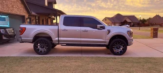

2" Rough Country leveling kit with 33x12.50x22s rides great!

I liked my 22’s on my 2019 F150 Limited — those look great on yours! Road rash was a constant worry with my polished wheels though.
Thanks! Yeah, the only thing I don't really like is that they stick out passed the wheel well a little more than I'd like and I don't really care for the fender flares. I might have the clear protective film put on the bottom sections to prevent road rash.
Up until recently I didn’t realize you could put vinyl on wheels — I think it would be a really good idea.
Yeah, I'm not quite as concerned with the wheels as I am of the lower portions of the side of the truck. But that's not a bad idea too! Wheels aren't cheap!!
