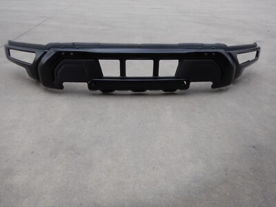

Looks like several available on ebay but they dont seem to include the bumper mounting brackets.
This one has them installed. You can see the 3 silver bolts and the brackets in the pictures of the backside of the bumper

Did you ever get the part numbers for the OEM fog lights? They contain the holes for the sensor right? Will the light from a Raptor R plug in to a Tremor? I assume no way to make the Stock Tremor ones work with the wings I am ordering above?
I noticed after I got my bumper that I did get the mounting brackets however, I am missing a bracket which helps to hold the wings on. I tried to search the part number on the one I have but I can't find anything. RL3V-17B760-A

I feel like the wing mounted to tabs on the bumper center section and not a separate bracket. I will check mine when I get home this evening though.
