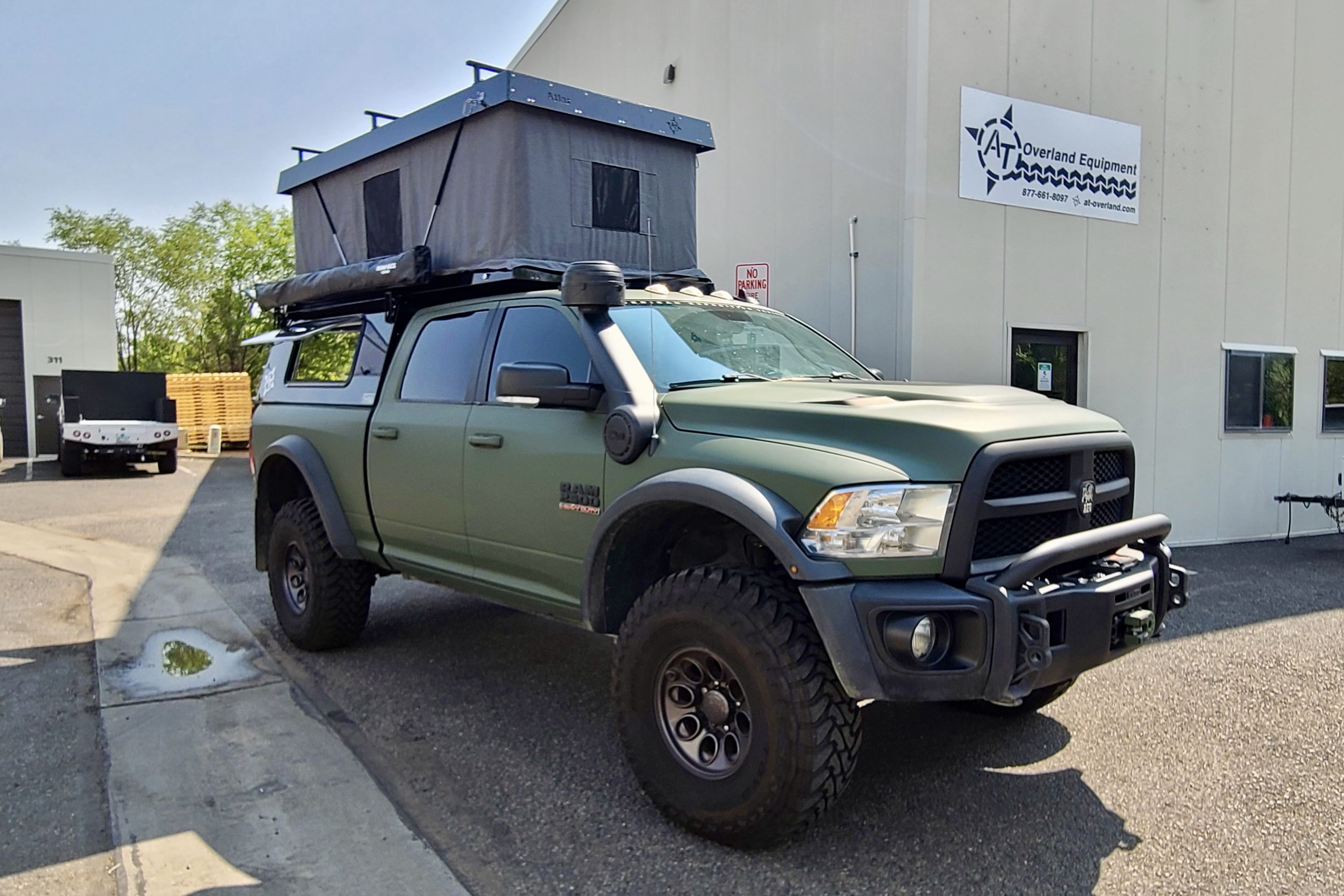

Great looking truck. I just installed an Alu-Cab Canopy Cabin on mine.
Yeah man. Looks fantastic! The one reason that kept me from spending the extra on the alucabin was the $700 dollar fridge slide i already have.
Ouch. Ya, that may have swayed me away too.
