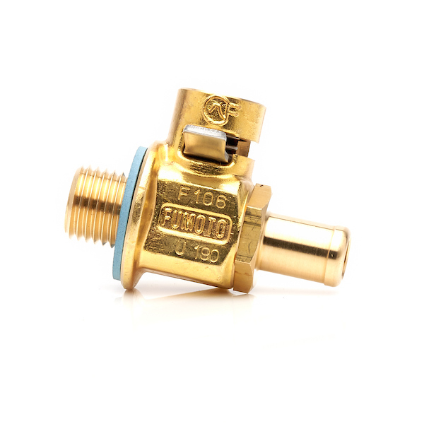

Mine has the nipple and I connect a section of clear hose about a foot long to it to drain into my catch pan. Usually start draining, change filter, and oil pan is completely drained by the time I get the filter changed.
This is the one I’m using
    • magic360alt
    • F137N: Long Nipple Oil Drain Valve With M12-1.75
F137N: LONG NIPPLE OIL DRAIN VALVE WITH M12-1.75​
Fumoto oil drain valve is a great investment and on level surface oil filter drains through back square in skid plate.

I also advocate the Fumoto oil valve as others had recommended from this page. works great, takes a bit more time but way less mess IMHO.
Installed mine with the Raptor skid plate last fall before a KOAR (Keweenaw Overland Adventure Retreat) up in the U.P.
Highly recommend both(y)
