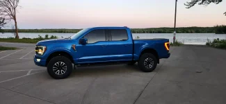

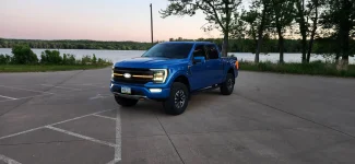

Slapped on a set of BroncoRaptor wheels with some 37” BFG’s! Removed the crash bars and did some very discreet inner fender surgery so everything clears lock to lock! Visually you can’t tell i modified anything on the wheel wells, I’m running Fox 3.0’s so i plan on bringing the front up about another inch.

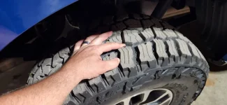

What are the actual dimensions of the BFG 37/12.5R17 tire?
Was most of the clearance issues in the front or the back of the wheel well?

Thanks! Another 1”-1.5” will be plenty clears everything as is, aesthetically it just need more front fender gap!
Just a tick under 36” tall and right at 12” wide BFGs always measure quite a bit smaller than most manufacturers. Clearance issues were mostly the backside. Front crash bars definitely have to go. Mine has the mod bumper so I’ve got a bit more clearance in the front over the non mod bumper.
