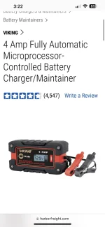

Looks like I just threw away $30 on the tender I planned to use. The video suggests the truck is drawing 5amps when asleep.

FWIW: Try it. I have been using a similar charger on mine. Mine will bring my battery up from 70% to 100% in a few hours.
